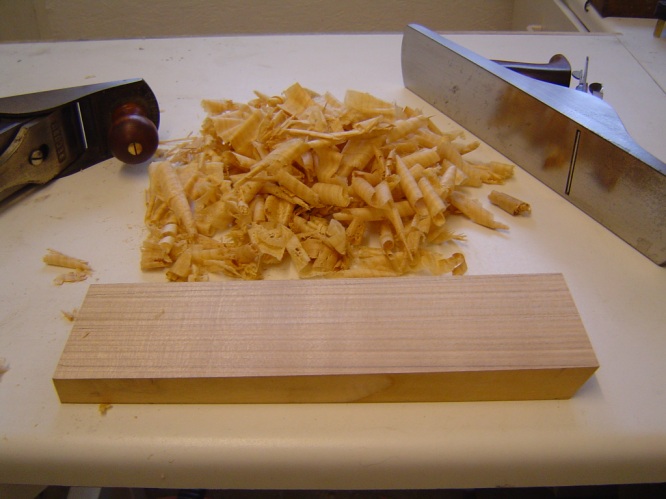

OK I know, this is just a bit of wood and some shavings, but there is just something about taking a nice old plane (or two) and shaving a rough piece of wood down until it has a surface like glass, I just love it.

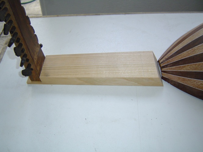

By the way this is a piece of English Cherry (Prunus avens) that is being transformed into the neck for an 8-course lute. Do you like the complex neck/body joint?

It's that 60 deg angle at the end. Sort of goes together like this, I haven't cut the corresponding 60 deg angle on the bowl yet.

That is a lovely pile of shavings Colin. From the looks of it, those plane blades must be sharp indeed. Is the neck/body joint on a lute just a butt joint. Is there no reinforcement for that joint?
PostPosted: Sun Apr 16, 2006 11:01 pm
Indeed it is just a butt joint, but it is glued and dowelled together. I did take apart an original Heiber lute last year for repair and between the two dowels was an old hand made screw that was used while the joint was being refined and the dowel holes drilled, usually it is removed and either left or another dowel inserted. On this joint in honour of that I will be using an old hand made screw as well!
The planes I use are all old Record or Stanley all with original blades, these two are both pre-war Records #4 and #5 their old tungsten steel blades take and hold an incredible edge.

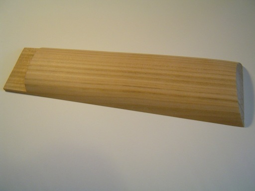

Finished neck, no finish on the neck.

Gorgeous! Not you Colin, your planes, your shavings and your lute! I hear you're somewhat of a plane nut and that we can get you goin' just by mentionning the tool's name! If it's true then, you must have the secret of happiness for appreciating simple things in life, i agree that my first shavings gave me goosebumps just lookin' at them! Good onya buddy!

is that really all there is to that neck join?
wow.
PostPosted: Wed Apr 19, 2006 12:06 am
That's it Matt, a 60deg angled butt joint glued and dowelled. I've taken apart a 13-course Bruner that had been together for nearly 300 years and the joint was still perfect.
